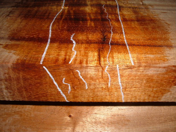

[QUOTE=Michael McBroom]
Something I discovered when I resawed my first sets of redwood was the wood can develop internal cracks that are not necessarily visible until you start resawing. I was using a friend's bandsaw to do the resawing at the time (a big honking 21" Felder), and showed him the cracks that became uncovered after resawing a few pieces. He called them -- I forget the term he used now -- something like "wind splits." He explained that, when the tree was young and flexible, it had probably been subjected to high winds, causing it to bend to the point of splitting internally.
So, I got to thinking that, if this is true, then possibly the light colored lines I observed were close to where splits had developed further into the tree. got in about an hour ago.)
Best,
Michael
Michael, unfortunately there are "wind fractures" or falling fractures in some large old trees. If a tree was young and flexible it wouldn't happen. The fractures are very visible on cut lumber, but I imagine spotting it in a log with bark on would be difficult. It would certainly show up on a peeled log. This type of fracture can happen when a tree is felled and it strikes a sharp opbject like a stump. If the blow is severe enough the bole with shatter of course. Tall trees can be subjected to wind stress and fracture on the opposite wind direction side of the tree. These fractures always appear from the bark side to the pith..always..and can resemble little spider webs of breaks. I've seen this predominately in some of the more brittle and light weight figured woods of a species like koa, mahogany, redwood and western red cedar for example.
Here's a photo of a nice piece of quartersawn koa with wind/falling fractures. It can be frustrating and is part of the dice game of buying units of expensive wood to find much of this defect which makes it useless.
